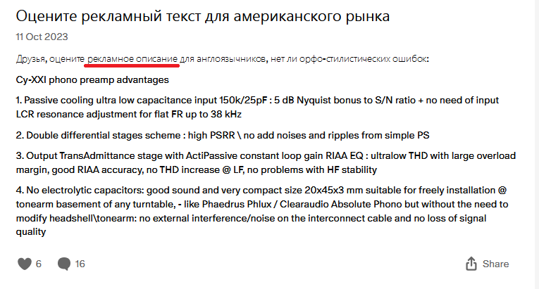

А для тех, кто таки схемотехник, то
https://www.*******.com/posts/otsenite-tekst-90783025
а кому бесплатный патреон не доступен, то словами:
Cy-XXI phono preamp advantages
1. Passive cooling ultra low capacitance input 150k/25pF : 5 dB Nyquist bonus to S/N ratio + no need of input LCR resonance adjustment for flat FR up to 38 kHz
2. Double differential stages scheme : high PSRR \ no add noises and ripples from simple PS
3. Output TransAdmittance stage with ActiPassive constant loop gain RIAA EQ : ultralow THD with large overload margin, good RIAA accuracy, no THD increase @ LF, no problems with HF stability
4. No electrolytic capacitors: good sound and very compact size 20x45x3 mm suitable for freely installation @ tonearm basement of any turntable, - like Phaedrus Phlux / Clearaudio Absolute Phono but without the need to modify headshell\tonearm: no external interference/noise on the interconnect cable and no loss of signal quality

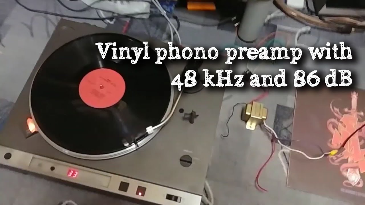

Схема есть тут:
